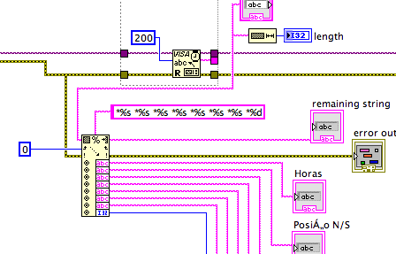

It looks like you have 57 characters in the string you posted. Try setting byte count to 100 or 200.
Lynn

Hi
problem continue...
http://imageshack.us/a/img11/4513/usk5.jpg
now appear new error. :S
