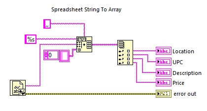

Lastly, instead of parsing each set of commas using the "match pattern" function, there's a function called "spreadsheet string to array" (also on the string palette) that does exactly what you're doing, except with one function:
Spreadsheet String to Array
I hope this is helpful...
