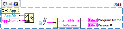

Try this ...
Bob Schor
(4,170 Views)
thanks for your time but it still does not work: returns the build version and not the source distribution
