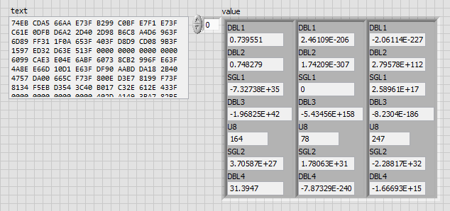

try something like this:
Your datastructure in the cluster MUST match the data in your file - right now it doesn't seem to be correct…
See here:
The text is shown in hex display: there are two DBL values (each 8 bytes) at the start, followed by 8 bytes of unknown content, then again 4 DBL values…

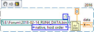

The key is that if you know the structure of the (binary) data written to the file, you can read it.  Suggestion -- do not give the file the extension "txt", as too many programs will think it is text that they can open!  I changed the extension to "bin" and wrote the following little routine:
I didn't originally have Mode wired, and it defaulted to Big Endian, and my "data" looked pretty screwy, so I specified Host Order, and got 225,000 reasonable-looking Dbl values (typically near, but less than, 1, with some values of 0).
As has already been noted, if you replace the "Data Example" (the Dbl "0" wired into the top of the Read function) with a Cluster that represents the "mixed format of Array data", you can read and auto-parse any format file you choose.  The "-1" says to do multiple reads of the same thing and build it into an Array -- if, however, what was written was a LabVIEW Array (with the Array header that provides the "shape" information for the Array), you'd make the Example an Array of Cluster and only do a single Read (assuming the file consisted of a single Array).  Of course, if the file had multiple identically-sized Arrays, you could have an Array Example and specify -1 to read in "all the rows" ...
