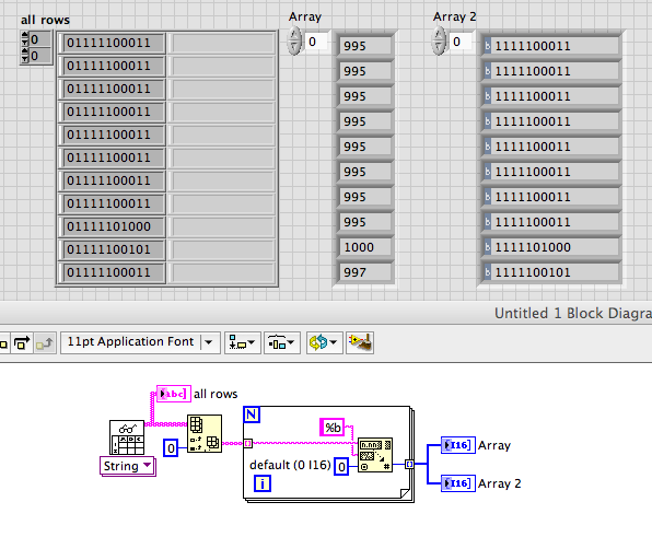

Is the actual data file (with the .dat extension) a text file like you posted?  If so you can use Read from Spreadsheet File.vi with the data type set to string. Then convert the output string array to an array of integers using Scan Value with a %b format string.
Lynn

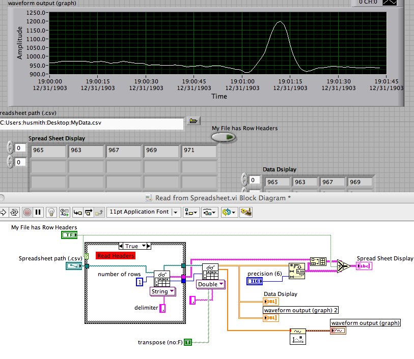

I  tried read from spreadsheet.vi seen in the examples, I am able to read but, waveform disply is important for me...
Message 9 of 15
(7,208 Views)
Wire a True constant to the Transpose? input of the second Read from Spreadsheet File.vi.  This will convert the column to a row and everything will work fine.
Lynn
Message 10 of 15
