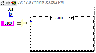

I am trying to decode parts of my serial data by using case statements in series.  I can read data in the first case statement but not in the second.
The code works if I only use one case statement, so it appears I cant read any data in the second case statement.
I need to read the data at the indicators "FOOTER" and DATA_ARRAY".

You are reading 2 bytes at a time (not 1 as described in the diagram comment) and since you are not using termination characters you'll get garbage if you have a 1 byte frameshift in the data.
Is the string going to the second case structure really "6100"? This is four bytes while you are only reading two to get that value, later displayed in hex format. It is safe to say that the string will never be "6100".

The check should be for hex string of 6100 (2 bytes).  If I try to read the data from the first case it is always zero, but in the first case it is correct.
I think the trouble is that when the data is passed to the second case statement it cannot be read.  Why should this be?

I've tried displaying data after first case and it is always zero, so the problem appears to be passing the MESS data outside of the case statement.
I changed the second case to detect zero and it works.  The second case is always seeing zero.

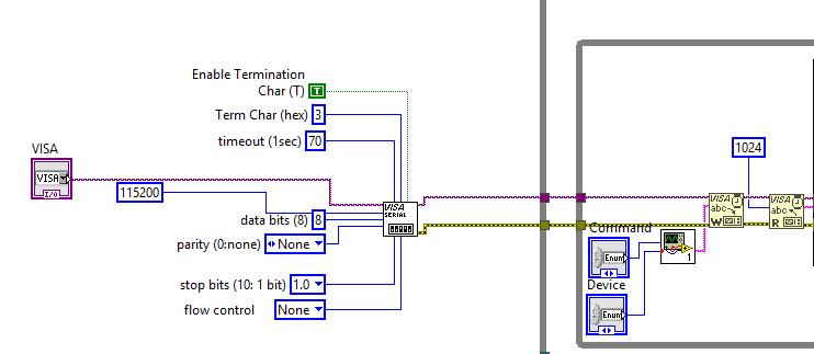

This is from one of my programs:
First I write a command and then i read a response. The response is only about 20 bytes long, but i use a term char and instead read a much higher number. If you don't want to use polling then just read a large number of bytes, Labview will give you only as much as it has, which should be your whole data packet, unless you are running the VI really slow.

@lafox24 wrote:
I still don't understand why I can't read that byte outside of the case statement.
Unless I have misunderstood your question, as mentioned earlier, you are reading 2 bytes, but your case statement is expecting 4 bytes.

Take your 2 bytes and typecast it to a U16.  Then wire that to a case structure.  Notice the radix is being shown on the string constant and the case structure selector and that they are both set for Hex display.
