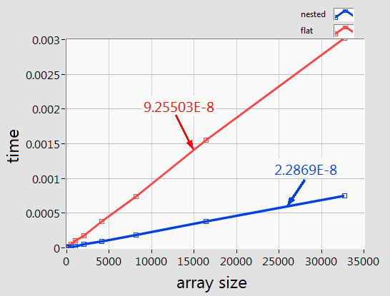

wiebe@CARYA wrote:
@EngrStudent wrote:
I have a case structure.  Whether it is case-switch or if-then, it is a conditional selector of which subset of code to run.
It's not a case-switch nor an if-then. It's a case structure Smiley Very Happy.
Actually it is either a switch or an if-then, and it does make a difference.  The two-choice (if-then-else) case structure is significantly faster than a case structure with three or more options.  Not just three cases, as soon as you add a third choice, even by using a list for the second case, you get a slowdown.
This means that nesting case structures is in fact a bit faster than a single case with multiple selections.  Now, before you build case structure pyramids, you encounter my "WTF rule".  If you optimize code to shave a few milliseconds, then the number of times you run that code had better be high enough, otherwise all of the time you "saved" will lost when you go to edit the code later and stop to say "What the f****?"
On the other hand, if you know something about your data, then it would be foolish not to use it.  If you know one case is going to be chosen 99% of the time, then I would suggest a case structure that handles only that case and put the checks for the other 1% in the default case.
I don't have the code at the moment, but I do have some benchmark results.  I created an array of strings which are either "True" or "False", and then I process the array in two different loops.  In the flat case, there is a single case structure with cases "True","False",Default.  This is the switch variety case structure.  In the second loop I have an outer case structure with cases "True", Default.  Nested inside the first Default case is a second case structure with cases "False", Default.  This is analogous to two if-then-else cases.  Here is the data:
The nested case is about 4X faster.  Does this mean it will speed up your code 4X?  Only if your code is like my benchmark, specifically designed so that the comparisons are the dominant operation.  I highly doubt that your code is being bottle-necked by case structure comparisons.
Message 9 of 20
(4,591 Views)
@Darin.K,
Why doesn't the compiler do that?  I like 2X multipliers for good things like execution speed.
-EngrStudent
