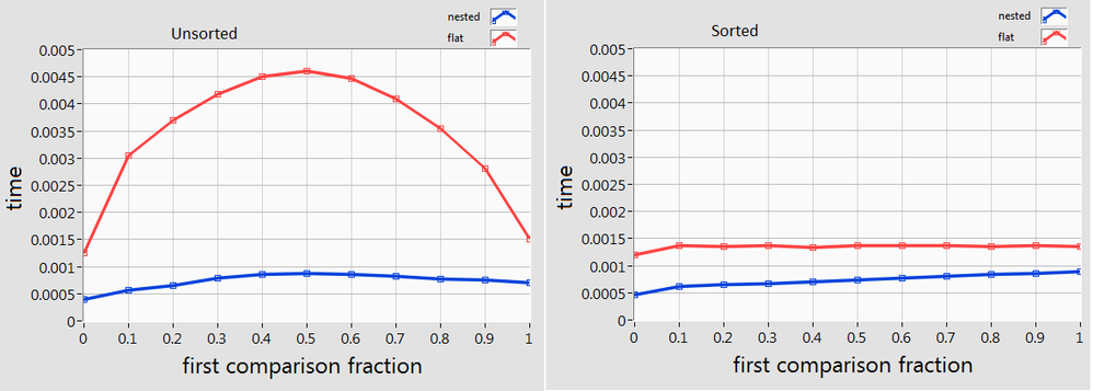

@Jacobson-ni wrote:
I didn't know about that potential nesting optimization but I would be interested if that scaled beyond 2 nested structures.
So I had a nice reply filled complete with graphs, but when I go to post the forums chokes, tells me I am not logged in and loses everything....
No time to rehash it all, but yes it does carry on beyond 2, at least through 5.  There may well be an inflection point, but I'd go to C/C++ to meet timing requirements if I had to do more than 3-4 levels of nesting anyway.
Here is some more data as I vary the distribution of "True" and "False" strings.  0 = all "True" and 1 = all "False"
The real culprit for the flat case structure slowdown seems to be a cache miss when a case is selected that is different than the previous iteration.  An array with a 50/50 split and random distribution is the worst-case scenario.  The same array, after sorting, is much faster.  The cost to sort is still there, obviously, this just helps to identify the culprit as a change in selection since the theoretical number of comparisons is the same in the two graphs.
Personally, I am inclined to nest structures in tight loops and be done with it the first time.  Given the IDE limitations, it is a real pain to go back if you really need this particular optimization.  It comes in handy many times when I am doing crypto operations (arbitrary precision math) as well as other 'sifting' or matching operations.
