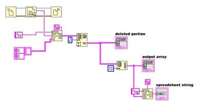

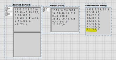

You read the whole file and the extract the last line. Read from spreadsheet file and Delete from Array would be the easiest way to do that.
/Y
Qestit Systems
Certified-LabVIEW-Developer
Message 8 of 80
