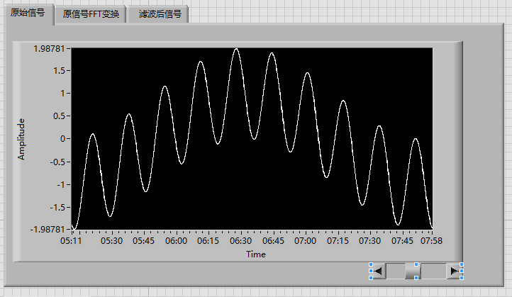

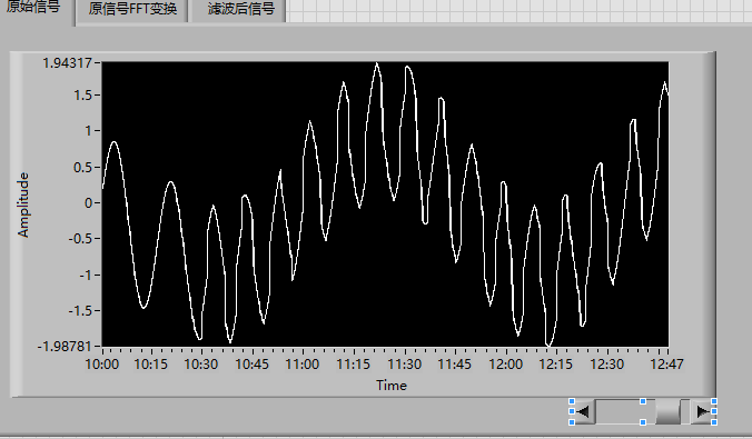

My vi (UdpRevLV.vi) receive data form MFC , and decompose the datas. After I added  the code to quit the program(exit button),  the displayed waveform is distorted,  is that the reason I got  wrong data?
correct wave is like thiscorrect wave is like thisnow wave seem distortednow wave seem distorted

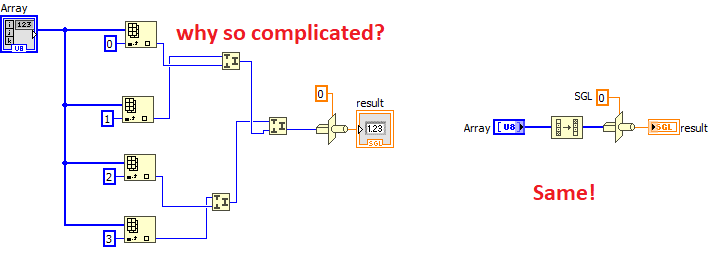

Overall, most of your code is 10x too convoluted. Why do you have so many local variables, e.g. the length. You cannot guarantee that the local variable reads only occur after the indicator has been written. I see a few other race conditions: You read and write from locals in parallel (array 2, fstrings), but the result depends on what happens first.
Even the U8 array to single conversion could be done with much less code (also, index array is resizeable).:

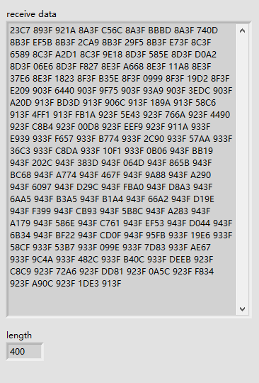

   Actually, each time I received 100 float numbers from MFC, below is the example of received data(I make it displayed in Hex format, it's length  is 400):
I'm really a novice. I really don't know how to simplified code.Thank you for the solution of U8 array to float number, it is really amazing.

Please attach the data as a VI (e.g. right-click the indicator containing the data...create constant, copy that constant to a new VI and attach it here). I cannot copy/paste strings from an image.
(4,794 Views)
Sorry,  here is the data.

You are still doing all this with 100x too much code. To convert the 400 bytes of data to a SGL array, all you need to do unflatten it using little endian byte order. (except for the filtering, this replaces your entire gigantic while loop!! :o). I haven't looked in detail at the rest of you code, but I am sure that similar simplifications can be done in many places.
