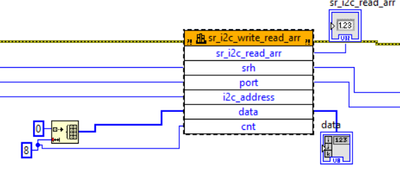

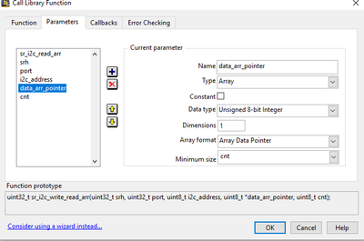

Dear
Now it looks as follows:
I wired the block like this:
The code is executing but it returns all zeros in data and the function itself returns 0, which means failure.
Any other ideas?
The Call Library Node call looks fine now. Is this 64-bit LabVIEW? In that case your SR_HANDLE may be not an uint32 but rather an uint64 instead! We can't know as you do keep showing only piecemeal information and always only in images. It's a lot easier to look through an actual header file or at a real LabVIEW diagram than trying to decipher things in an image.

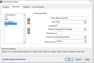

Thank you for your reply.
The buffer is the 'minimum size' specification in the parameter settings?
The wiring would be correct like this?:
Because this code is executing, but the function itself returns 0 (not succesfull) and the data indicator is all zeros.

Thank you for your very fast reply, I was still replying myself.
You can find the vi in the attachment.
I know srh and address is correct because the other functions are executing correctly.
