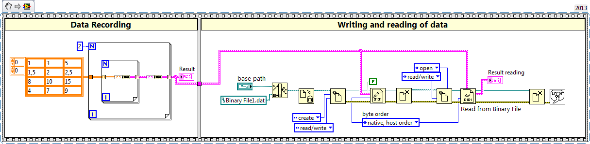

I have a dynamic array which results from calculations then plots graphs. I would like to record the data to view the graphs elsewhere or later.
My routine does not work, can somebody explain me why?

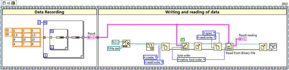

 Hello Gerd.
in your picture there is no "Dynamic Datatype" array. There is no "dynamic" data at all. All I see is a 2D array constant…
When I said I had a dynamic array, I did not mean Dynamic Datatype array but an array (in orange, on the left) that may vary in size, depending on previous calculations.
What does not work?
What should happen is the indicator Result reading should be active and look like Reading,

Here is a repost with simpler base path and file name...
(to try the routine, just drag and drop this image in the Block Diagram of a blank VI)

Hello GerdW,
Thank you very much, this works just fine!!!
Can you explain me why you use this?

Hi Alain,
IndexArray: ReadFromBinaryFile expects a description (or the datatype) of ONE data element in your file. As you wrote an array of elements you need to provide the scalar element as datatype description.
-1 constant: read the help of ReadFromBinaryFile. It explains the "-1"…

Hello mon39Por,
Here is a repost of my VI with all labels on it.
As I said earlier, the second part of my VI is based on Right-click < File I/O < Read from binary file < Detailed Help < 3rd example. Then I merged both VI's.
