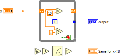

Your while loop in the subVi is really dangerous, because it will never stop if the input is e.g. zero by accident.

5. I see your point here, while this vi should never be able to be run if there isn't a waveform, I can see where changing this to a case structure with a default would be safer

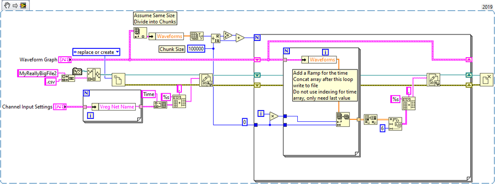

The problem with your VI is you are trying to do everything at once; that creates multiple memory copies.
You need to write in chunks of data.
Here is a start below, the block diagram can probably be reduced to the size of a small FedEx package.
2018 Version saved.
You need to add the part for the time array, I don't have time to do that. This should use less memory; play around with the chunk size, larger chunk more memory but faster, smaller chunk less memory but slower save.

Thanks for this. I'll have to add in some logic for if the data set is less than the chunk size and some things like that, but initially this looks to help me out with what's going on. I'll put it through the paces for sure.
The logic is already there, the For Loop will run once unless the number of points is 0. Test it.

You don't really need a loop. for inputs <1, here's what you could do (or similar).
 That's a fancy algorithm, I'll have to look into it and see what's happening...
I came up with a solution and it seems to be substantially faster, as well as no longer having the memory issues that I previously experienced. I'm sure it could be tweaked to look better, so I may work on it a bit more. I think the chunking was necessary and appreciate the perfect primer from @mcduff.
