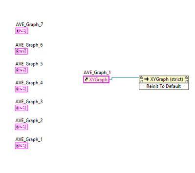

Reference / invoke node by way of for loop.
Just a general conceptual question:
is there a way I can initialize the graphs- perhaps cycling them efficiently in a for loop?
Cycle through the label?

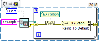

Label.Text or ClassName will work.

I can't seem to find that input VI on my palette anywhere?
(1,530 Views)
That's the Traverse for GObjects .vi which is only available with scripting enabled. Tools>Options>VI Server to find how to enable scripting. What he replied with is a snippet which you can download to somewhere on your computer and then drag it to block diagram and it should create the code for you.
