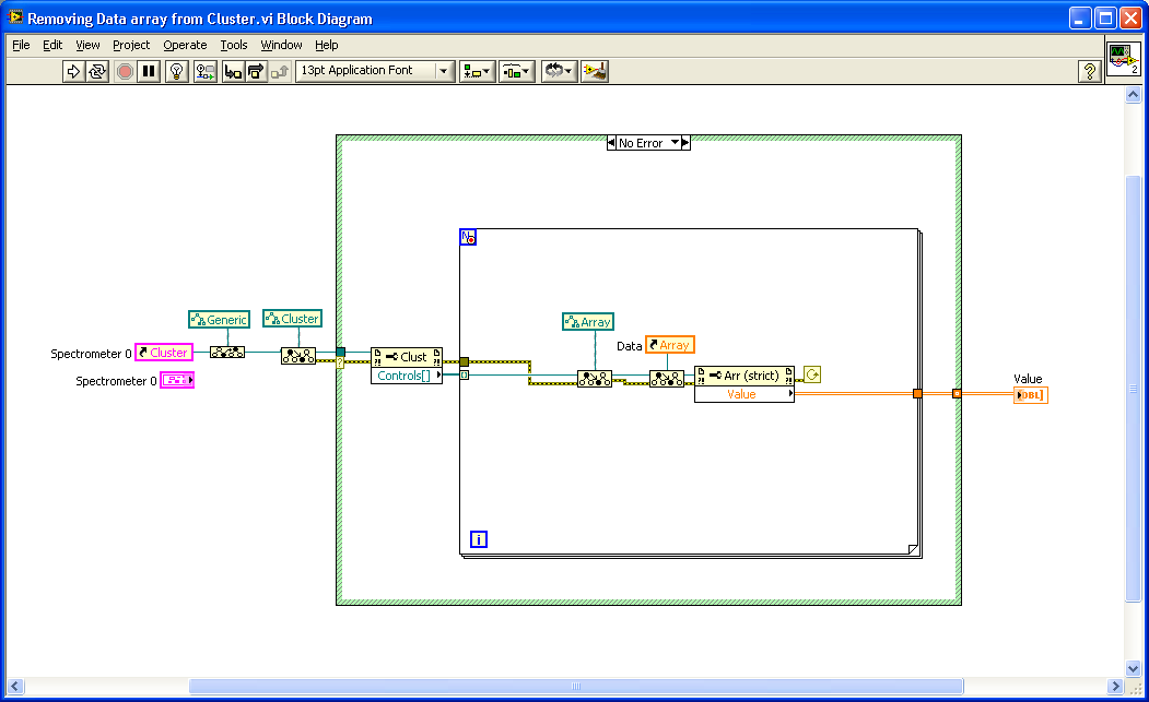

After stepping back and looking at the bigger picture, ...I first want to pull an array of data from a cluster, send the appended cluster to a vi that pulls the names and values out, then process the data array differently.  This is the base action that I want to do, and then if there is another cluster in the first cluster I was looking to pull it out and deal with it like I first requested.
Attached is an example of what I am trying to do.
Much thanks,
  Vince
Much thanks,
  Vince
You were sooo close.
Ben
Message 8 of 13
(4,585 Views)
Gosh Ben--thanks for the quick reply,
But I get error 1057 from the 'more specific class' inside the for loop.  My 'class specifier constant' does not have the braided look to it.  It is the Generic>GObject>Control>Array, is that correct?
Thanks again,
  Vince

Ignore the "braid" that is because I have the option set to show constant folding.
On the front panel right click the Array INSIDE the cluster and create a reference for the array only. Use that ref for the final "To more Specific".
Post your code if that does not work so someone can take a closer look.
Ben
