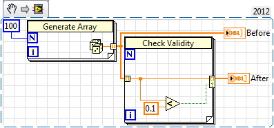

Just use conditional tunnel mode.
Something like this:

Hi~
I tried .aCe. 's solution and it is working. Thanks very much.
