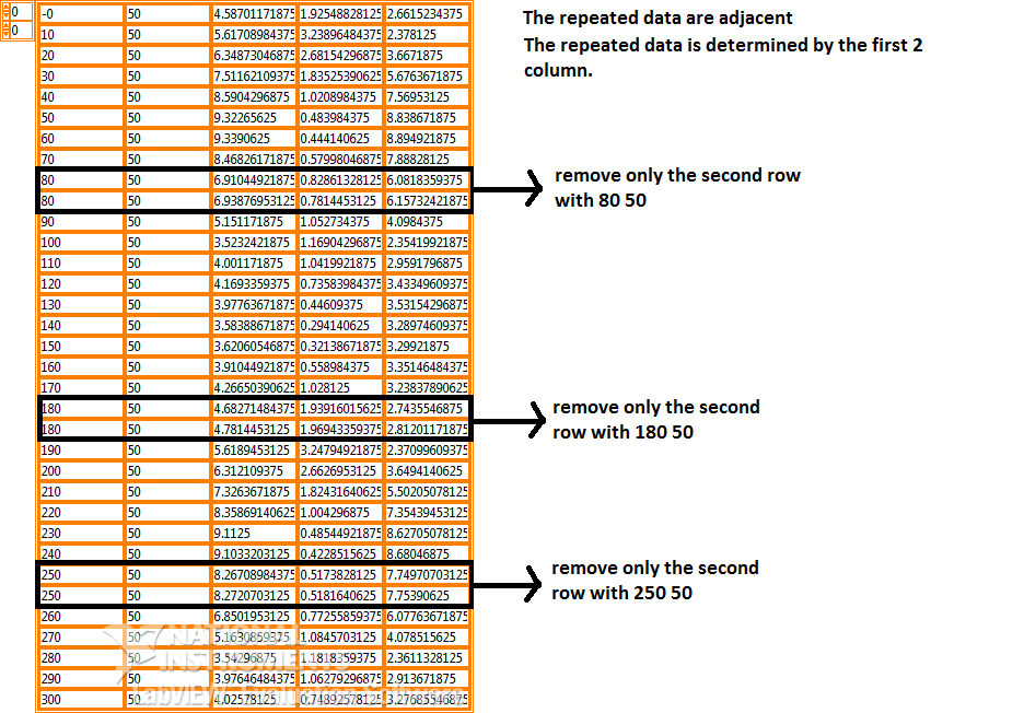

Remove repeated row in 2D array
How can I remove the row for second repeated data in my 2D array regardless of the 2D array size.

Hi Altenbach,
As long as the first 2 column repeats, I will delete the second repeated row. The datatype is double. The repeated data is different at every run.

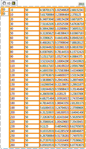

Can you attach a simple VI that contains the array of post #3 as a diagram constant?
The basic algorithm remians the same, but instead of a single column you would take the array subset of the first two columns, autoindex it the same, and compare the array of two elements with the previous (compare aggregates).

Is it okay for me to post snippets? This is my first time creating a snippets.
Message 8 of 12
(6,569 Views)
Try this...
There are many variations possible. 😄
