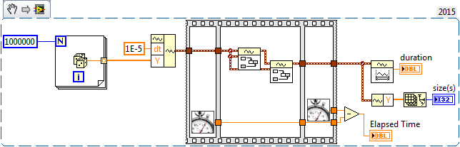

I'm puzzled -- I'm clearly doing something very different from what you are doing in your code.  It looked to me like you had a waveform with a million points (10 seconds at 100KHz) and you were joining it to two other waveforms of some size.  So I cobbled up some code to do just that -- it generated a Waveform with a Duration of 30 (I appended the Waveform to itself three times, so 3 * 10 = 30), the size was three million points (also correct), and it took 13 milliseconds to do this.  Here's the code ...Concatenate Waveforms.png
Obviously, I'm missing something important (or have focussed on the wrong part of the problem).  It would seem to me that if the waveform plays for 10 seconds, and you can generate the next iteration in a few milliseconds, then exploiting LabVIEW's parallelism leaves you with 9.98 seconds to do other interesting things ...

OK, a 10 hour waveform at 100KHz is 3.6 Giga-samples, so if we're doing double-precision waveforms, that's just under 30 G Bytes.  I see a real problem here ...

You've got a point, it's probably fair the labview takes a few seconds to produce that much data.
