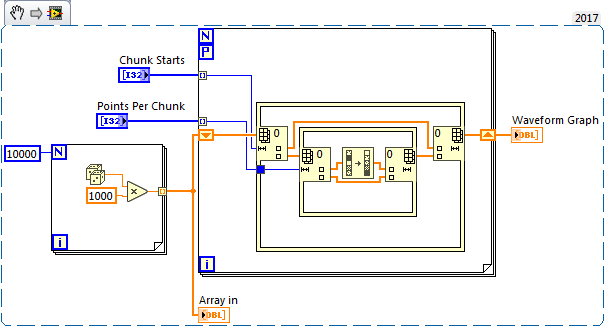

I am working with a large set of data (if I am not careful I crash the program because the computer can’t allocate enough to Labview) in an array and would like to loop through and modify portions of the array at a time.
I have implemented the code just fine in a regular for loop, but can’t seem to find a way to parallelize it and still convince the compiler I am not going to step on myself with other loop iterations and maintain my memory footprint.
Basically the data is really a bunch of different arrays with a wide range of lengths but putting it all in a 2D array will drastically increase the amount of memory required.
So instead I have a 1D array of data (all concatenated back to back) and another array containing the length of each sub-array, and for ease of use a third array containing the starting locations of each sub-array.
In each loop I want to grab off a sub-array, do some manipulations to it, and then put it back in the same memory location. I have tried a few different approaches but not been able to find the right solution. I could use replace array subset and a shift register but I get a "dependence between loop iterations" error. I could also just peel off my various sub-arrays and concatenate them back together on the way out of the loop but I believe this will double the memory required.
I have included a sample code of one of my various attempts that is similar in nature but vastly simplified from what I am trying to accomplish.
Ultimately I am doing the work to make sure there are not actually any dependencies between the loop iterations but Labview doesn’t know that. Is there a better way to do this, or can I tell labview to ignore this warning and compile anyway (preferably only in this instance)?
Any help is greatly appreciated.

Haven't tested, so I suggest you test this. Below is a hack to get parallelization without significantly changing your code too much. Have not tested memory footprint nor execution speed.
mcduff
The IPE(DVR) will block concurrent access to the DVR data and each parallel instance will need to wait. The IPE(DVR) can only execute serially. Nothing gained. (Haven't tested it. Feel free to verify my claim ;))
See point #4 here [link removed; article no longer available].
QUOTE:  "The In Place Element Structure has a pair of nodes for Data Value Reference Read/Write for dereferencing and rereferencing the data, respectively. This structure blocks the execution of other structures using the same reference until it is finished and the data has been rereferenced."

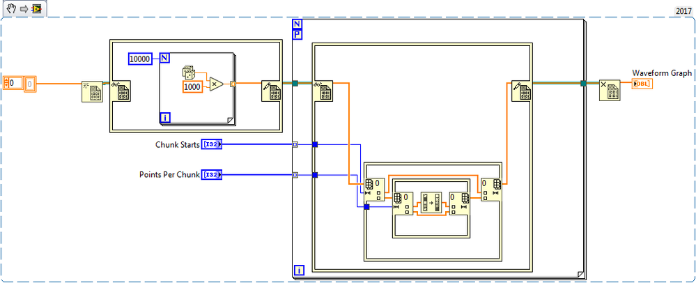

Here's equivalent code that can be parallelized. It is also arguably easier to read. 😮
(I have not benchmarked if parallelization really gives a speedup. Not sure about the overhead of that concatenating tunnel ;))
