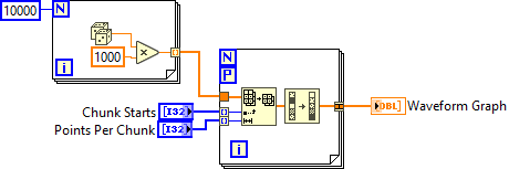

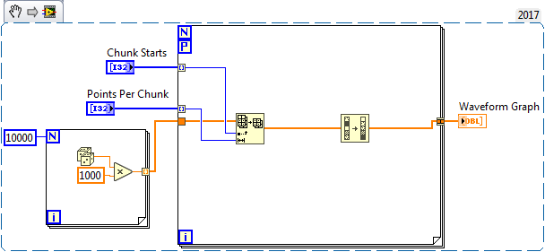

@altenbach wrote:
(I have not benchmarked if parallelization really gives a speedup. Not sure about the overhead of that concatenating tunnel ;))
I get about a 3-4x speedup comparing a parallel FOR loop with a regular FOR loop using the otherwise identical above code.

Just to make sure we are on the same page, your complicated code with the pyramid of IPEs (with parallelism removed) performs nearly identically (within a few %) to my much simpler version (also, with parallelism removed).

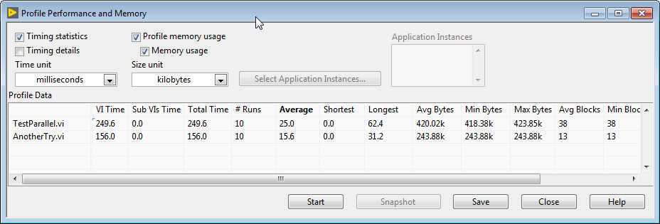

@Altenbach - I believe you are correct.
I modified my original code to get rid of parallelization and remove some of the IPE structures.
See below.
AnotherTry.viAnotherTry.vi
I also modified Altenbach's Code to include a sort array.
See below.
ParallelTest.viParallelTest.vi
Did not extensively test nor bench mark, but attached are results for the VI profiler. The IPE saves memory if that is important to the OP.

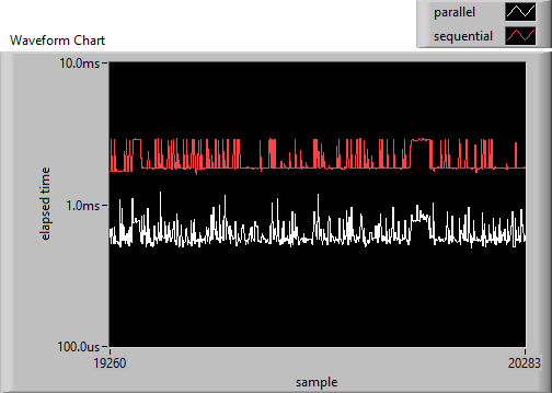

Also, your "another try" performs nearly identically to my sequential version. My parallel version is still 3-4x faster.

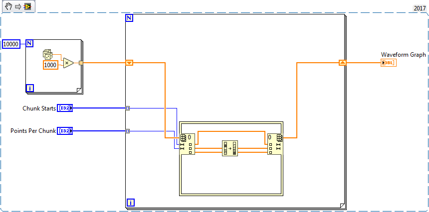

Well, I don't know, but it seems the IPE is not as optimized as you think. For example if you unroll the loop completely as follows (still the same result), it does not speed up over your code, even though all sorting operations can execute in parallel ( ... and I am currently on a dual Xeon with 16 hyperthreaded cores (32 virtual cores).
I am not sure about memory use but the LabVIEW compiler is typically good at keeping things in-place as much as possible, even without the IPE structure.
(Of course this is not really scalable, just wired up as a test scenario)
