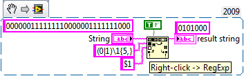

Here's a non-regex solution. 😄
Not fully tested. Please verify correct operation.
Any advantages over the regex from Darin? Is it something to do with memory/speed/performance?  Just curious.

You should benchmark it. Are the strings big enough that it actually matters?
Actually I wouldn't know. This is something only "tintin_99" would know. But I just saw Darin's example and looks simpler (code wise) than yours. So I'm thinking if regex has any shortfalls (in this case) compared with non-regex version.

@tintin_99 wrote:
Many thanks
Yes, just modify the innermost case structure. for example you could make folliwng cases:
  • [4..] Same as current case
  • [default] output empty array.
etc...
