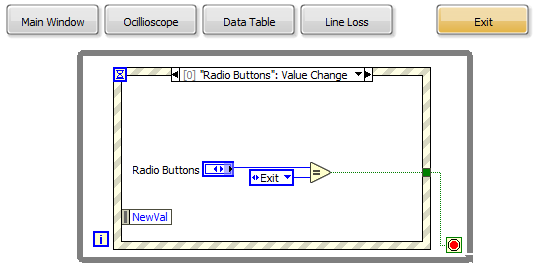

I doubt I ever posted the old code, but here's how your code would look leveraging radiobuttons. 😄
Arguably simpler... And they even work in edit mode. 😮
(note that I made the container transparent)

How did you change the buttons?
For the life of me I messed around with the Radio Button control and could not change anything besides the text.

@altenbach wrote:
I guess I don't understand the question. A radiobutton control is just a special container for booleans (any type, flavor, amount) with some logic that only the last pressed is true.
The type is an enum containing the labels of the Boolean as item names. The value is the current selection.
Like clusters, you can arrange the elements any way you want (turn off autosizing, arrange horizontally, etc.)
Yes, before radiobuttons, we had to make our own logic. (Still need that for special versions. I have one where the last two are true ;))
(Posting by phone, cannot test you snippet)
(And please vote for this old idea :))
OMG shoot me now. I never realized you could just drag booleans in and out of it.
