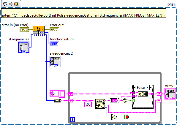

Hi!
I tried once using an array of U8, converting it to a string and then splitting it in an array.
Here's my old piece of code (the split part can be cleaner ;=) )
Marco

Marco,
You are a genius! Thank you so much!
