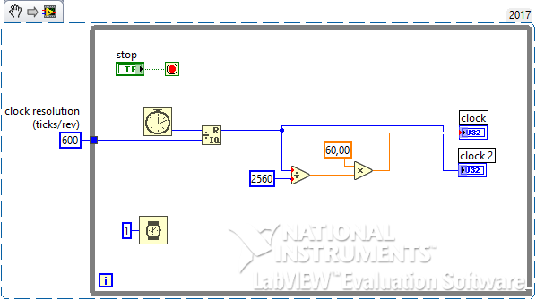

I have just inherited a terrifying VI (first VI attached) from my supervisor - it is supposed to run a clock (with just the seconds arm on screen (starting the arm from a random seconds position i.e., not 12 oclock every time). The arm spins around until a user presses a button. Then a beep plays. Then the user can enter where they thought the clock arm was when the beep played.
This code has been used and abused by various previous students adding things, and I am trying to dilute it down to its purest form (clock start, button press, enter response), but am having trouble.
I tried to just pull the clock itself out (second VI) to start with, but the arm only cycles around the first quarter of the clock and then jumps back and starts again at 12...
Does anyone have any idea why this might be happening? Maybe I missed some 'continuation' code that gets it to keep spinning, but I can't see the wood from the trees in the parent VI...

just replace wire and set correct limits values

Hi Artem.spb,
Thank you for your reply and the useful picture - however, weirdly, when I rewired lower output to 'clock' and upper output to 'clock2' the clock arm now just does not move at all...
I saw your other note about 'set correct limits value' do you mean the '60.00'? I see in your image that yours looks like it has a comma (60,00) not a decimal point (60.00), as mine has. I tried to enter a comma between but it wouldn't let me...
Sorry to be such a dunce but the issue is I don't really understand what that bit of code does (R / IQ), I looked it up but still fail to understand as I am mathematically illiterate 😞

I also tried this
https://forums.ni.com/t5/Example-Programs/Creating-an-Analogue-Clock-Using-Gauges/ta-p/3511908
Removing all arms but the second arm, and playing around with the numbers to get it to move faster. But when I removed the other arms, the seconds hand got stuck again... does it need the other arms to work properly? that seems weird...

why you ignore my message?
You have 2 (3) arms, but only one with scale. Another scale(s) hidden. You need show scale for all arms and set correct ranges.
In your vi the second arm ("ms")  has range 0..2400, and get values 0..600. This is reason why it moves in first quarter only.

Hi Artem,
I did reply 😄 (see comment above)
Though that comment is not needed now as the clock rotates! I feel silly not realising that clock resolution meant how far around the arm would go.
Setting it to 2400 made it rotate all the way around, but it was jumping at the end. So I figured maybe I had not sufficient rotations in there for the other values, and set clock resolution to '2560' to match the other number being divided there, and it looks much better!
How come you suggested wiring the divided output to 'clock' instead of 'clock2'? this seems to make the arm get stuck on 60. No matter though, the other way around works!
So happy thank you!
