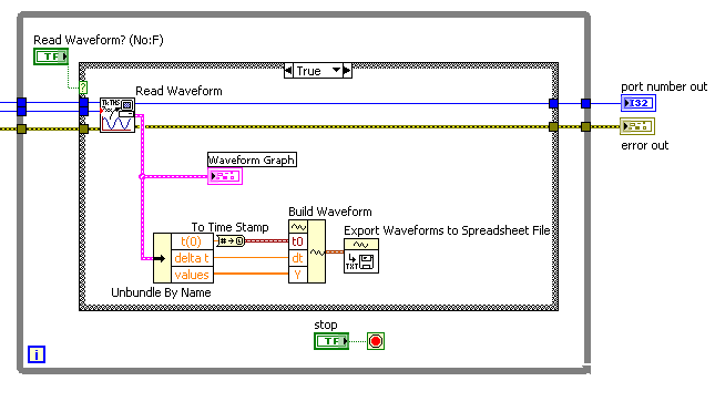

The first thing is that you don't have anything in that program to operate continuously. DO NOT use the run continuous button on the toolbar. I can't save your VI back to 7.0 so I've attached an image. There is a while loop around the scope read and some functions to get the data and save it as a text file. I did not make this very fancy and you will want to add a path control/constant so that you don't get prompted for a file name all of the time. It's also not extremely fast since it saves data as text.

Hey guys,
Thanks for helping, it works now and saves it.
I have one final question.  Is there a way to get LabView to save all the data in one file without it rewriting over the previous data so that it is just a continuous stream of data that saves start to finish until the program is stopped?
Attached is my updated VI
Thanks again, it has been so much help.
-Pat
Message 4 of 8
(9,380 Views)
Hi preilly,
connect a true constant to the "append to file" input. Smiley Happy
Mike
Message 5 of 8
(9,376 Views)
on the bottom of your file write VI there is an input asking if you want to append to an existing file (T) or overwrite any data (F).  if you wire a true constant to it, you will append all your data.
edit - gah, beaten!
Message Edited by JeffOverton on 04-25-2008 03:18 PM
Message 6 of 8
(9,375 Views)
Ahha, that was an easy fix.  Thanks all!
-Pat
Message 7 of 8
(9,367 Views)
also, you should use a control to stop your program to ensure your last data point is written.  it will go true and trigger the loop to stop iterating, so all data writes will happen.  if you just use the stop button in the development environment you could potentially interrupt any data transfer, as well as potentially leave instruments hanging.
