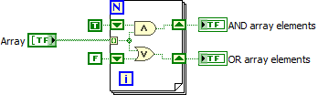

Yes, the behavior is correct and can be explained by the this more explicit (but equivalent!) code for AND and OR array elements.
If the array is empty, the FOR loop is skipped and the shift register value is returned unchanged.
(Of course in reality the "OR array elements" version can terminate early at the first TRUE, etc. not shown)
If an empty array input is a possibility, you need to program around it, e.g. as cbutcher already showed above. Often you can make changes upstream that this cannot happen.
