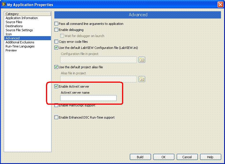

Hey Mike,
Two things to verify,
1. The LabVIEW run time engine is installed.
2. You've enabled ActiveX for your executable. See the picture below.
Chris C
