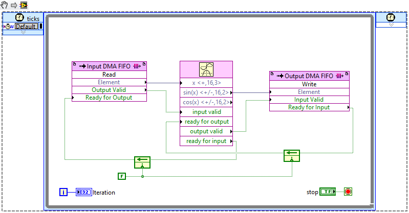

Instead, you should accept the latency (sounds like you already went through this bit) and then by modifying the setup of the High Throughput Sine function you can set the behaviour of the function.

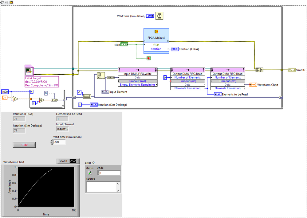

Attached is a zip file containing a project with a simulation showing this - by setting the throughput to 1 cycle/sample the latency (for a 16 bit input) becomes 16 cycles (17 if reading from a register).
Together with handshaking (should be implemented in case of different input rate or downstream usage, etc), this allows you to continuously stream data.
Desktop Execution simulationDesktop Execution simulationFPGA VI with Handshaking interface setupFPGA VI with Handshaking interface setup
If you run this simulation, you'll see for the first 16 iterations, "Elements to be Read" will be 0 (nothing was output on the FPGA) and the input value will go from 0 to 2pi*15/1000. Then the next value will be input, and "Elements to be Read" will be 1. It will never change (because you're writing one new value per SCTL iteration and reading one value per SCTL iteration), but the returned data value isn't 2pi*16/1000, it's 0. Then the next value is 2pi/1000, and so on. The output will lag the input by 16 cycles, but this is constant, and the throughput becomes 40MHz (SCTL clock frequency) in this example (although since this is a simulation, the throughput is much much lower, and primarily determined by the "Wait time (Simulation)" input 😉 )

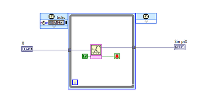

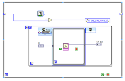

In order to test the performance of the SCTL I just test the function High Trhoughput Sin like this:
This takes 31 µs...
This is what i expected :
With  a clock of 40 MHz (50*17)/40 e6 = 21 µs
With  a clock of 80 MHz (50*17)/80 e6 = 10.5 µs
Message 10 of 19
