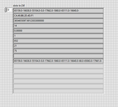

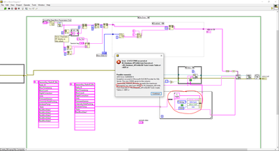

I'm trying to the write the values to SQL express DB from LabVIEW 2018.I am using String as a datatype for my DB table column. Since, I am using String datatype, I have to give the size of the column. My data contain nearly than 10000 characters. So, I given size of the column as 10000. But when I am trying the run this code I am getting the error. Refer pasted image below.
My question is, is there any column size limitation for the string datatype? If yes, how can I give more than 8k characters into one column.
Attached here Front Panel and Block Diagram of my code.

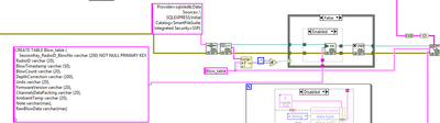

But, there is way of increasing it, using Varchar(max). See below screenshot..
Above image, I used SQL query to create the table as per my requirement. It's worked fine.
