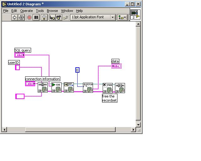

I got a problem when I collect data from a MS Sql server database with the Database Connectivity toolset.
The data I get is not all correct.
I got these data
AdjustedQuantityPerExpanded   OrderQuantity   ComponentItemNumber   ComponentItemDescription     TotalQuantityRequired
1                                                         10                        60001929                             CONN SL M 4 LEADED            10

Here is a picture of the funktions I use in labview
I use:
Labview 6.1
Database connectivity toolset 1.0.1

Hi Bjarne,
Can you upload your VI and database file so I can test it on my computer? I can see from the picture, that you are trying to fetch data from Column 1. I assume that column is "TotalQuantityRequired", you can try to give it the correct return type. You can also try to use "DB Tools Fetch Recordset Data" function instead.
There is a more detailed explanation of how to fetching data with SQL functions in Labview at Database connectivity toolset manual (Chapter 5):
https://www.ni.com/docs/en-US/bundle/321525c/resource/321525c.pdf
I have also found a Labview .llb, where there is a Database update.vi that you might can use for your application:
Updating Data in a Database Table Using the Database Connectivity Toolset: http://zone.ni.com/devzone/cda/epd/p/id/3150

Hi
I found the error and I am sorry to say that it was mistake of my own.
I thought it was in the SQL functions the problem was, because I got the same data when I used Access and solved that by making a "refresh links" in Access.
I found out that I got the right data in Labview, but my manipulation of data was infected with a bug
