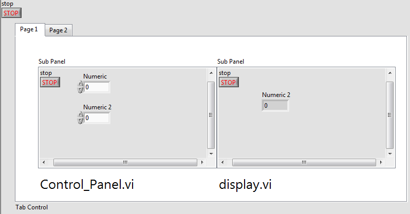

I've been looking into SubPanels in order to run several VI in one main VI. One thing i wish to achieve is having atleast 2 SubPanels displaying the same VI, BUT, they need to behave as one! Meaning that if I make changes to the VI in one of the SubPanels, the changes also applies to the VI in the other SubPanel.
The following pictures displays my code. The Front Panel consists of a tab control with 2 tabs. The idea here is that I have Control_Panel.vi which is the VI that will be used in several SubPanels, in this case, 1 SubPanel in each tab.
The VI's loaded in the SubPanels have the folllowing functions
  • Control_Panel.vi: Adds the values in "Numeric" and "Numeric 2" and writes the results to a shared variable called "result"
  • display.vi: Writes the value from the the shared variable "result" to "Numeric 2"
  • display2.vi: Reads the value from the shared variable "result", multiplies it with 2 and writes the result to "Numeric"

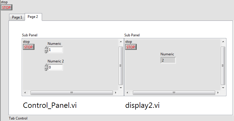

The problem here is that if i change the value in one of the Control_Panel.vi VI's, this only applies to that VI, leaving the other Control_Panel.vi with the old values. This results in the display VI's values flickering in between the results calculated from each of the Control_Panel.vi VI's
I want to use the SubPanel solution because that's the way we're working in this project. Is it possible to make the Control_panel.vi VI's behave as one using SubPanels?

It's only Control_Panel.vi that appears in both tabs. if you look closely, you'll see that the other VI's that got loaded are not the same. In tab 1 it's "display", while in tab 2 it's "display2".
Anyhow, whats imprtant is that this is not the final product, but sort of a training for the actual project. Imagine that we will end up having several tabs (5-6), but we only want the Control_Panel.vi in 2 of them, while having other VI's in the same tabs as well (as the pictures illustrate).
That's why i would like to have an understanding in how to implement this.
