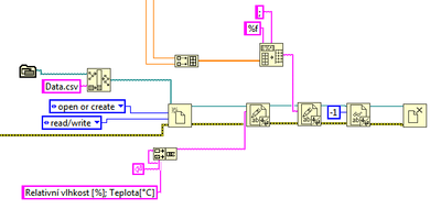

I have app, when i read from sensor. I want my sample save in .csv file.
Saving is in while loop with reading from sensor.
But always i get :
Data is always overwritten on same line.
If i want get time stamp to every sample i need my array with values unite with time stamp?
Is possible in LabVIEW treat for some reason malfunction of communication? (I mean, if sensor stop workings, i need get data like xFF still write on my csv.file)
Thank you for your ideas.

HI Yaamamoto,
when you want to append data at the end of the file you need to set the file position to the end of the file after opening it…
You can also format the timestamp to text and concat strings before writing to file.
You can handle any malfunction as you like - you only need to create your program as needed by your requirements…
Message 2 of 14
(5,694 Views)
If you're doing this inside a loop, you should usually open the file before the loop and close after, and keep a file reference inside a shift register for the Write operation.
This will automatically keep the cursor at the end.
If you have to open and close repeatedly, then you'll need to use Set File Position as GerdW said.
You can see this link for more details: Append to a Text or Binary File in LabVIEW
This is copied from the 2nd link and explains a bit more (copied here for ease of reference):
When a file is opened in LabVIEW the cursor is set to the first position in the file. When a Read Text File or Read Binary File function is used it scans the full file and subsequently moves the cursor through the file to the end and so when a write occurs after that it will do it from the end.
Message 3 of 14
(5,667 Views)

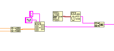

Thank you.
I tried get timestamps to samples, but Humidity is never written.
I connect timestamps :
Message 4 of 14
(5,659 Views)
Accepted by topic author Yaamamoto
With that image, it seems like you'll be missing a delimiter.
Add an additional input to Concat Strings in the middle and wire a ";".
Message 5 of 14
(5,656 Views)
