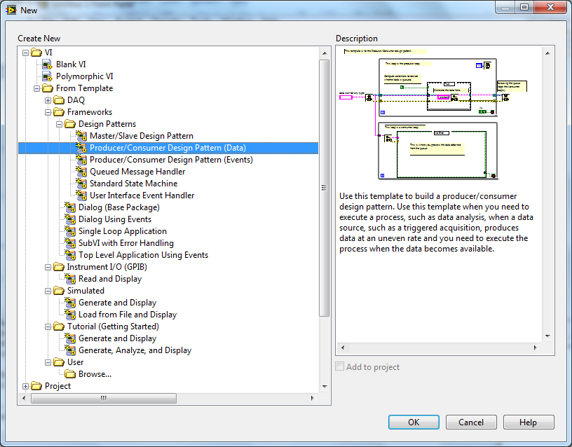

The second thing I see is your architecture.  I'd direct you towards a Producer-Consumer, where you capture images in one loop and write them to file in another, separate loop.  Transfer the image data from your capture loop to your file loop with a queue.  To look at an example of a Producer-Consumer architecture, in LabVIEW click "File...New..."  then under "VI" choose "From Template...Design Patterns...Producer/Consumer Design Pattern (data)".  Changing your architecture will allow you to capture images at one rate, then write them to file at a different rate...so that writing the images to file doesn't slow down your acquisition the way it does now.
