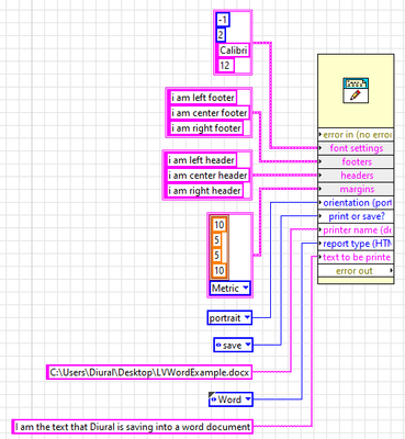

Thanks for answering, but I just can't get a hold of an answer. I have created a word document with string input but cannot find how to just convert it to a pdf and save it as is. I am attaching my vi so far (LV2012). Thank you for the help and sorry for the question which seems like and easy one (not for me).
Cheers,
Diural

Hi Diural,
in the RGT palette you will find a PrintReport function, and there is a QueryAvailablePrinters function. When there is a PDF printer on your computer installed then it's easy to print to PDF.
Another option is to use ActiveX (which RGT is using under the hood anyway) to directly command Word to "SaveAs" PDF document: example found in this LabVIEW board
Message 4 of 9
(4,531 Views)
