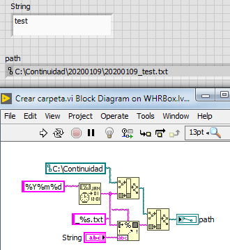

Hi 99,
again you hijacked that old thread instead of sticking with your own one…
Sorry to bother you. I tried to create a folder on Local Disk C through this program that I attached below but I can't create the folder.
What's wrong with your VI? Where do you fail?
Did you check your resulting path?
It's not recommended to have points in file-/foldernames.
Probably you want one more "\" in the path between the first and 2nd date string!?
Why don't you use BuildPath to build a path?
Why don't you use FormatIntoString (or FormatDateTimeString) to format your date correctly?
I recommend a format similar to YYYYMMDD to allow simple sorting of files/folders in an explorer window…
As simple like this:
