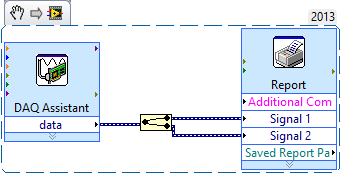

I managed to save data from waveform graph into excel file and saving the plot into excel but individually. I'm aiming to save both the data and the plot in an excel file. May I know how do I do it? I've tried using the Write to Measurement File vi and also the invoke node of the waveform chart but it's still not giving me what I've wanted.
The above was only for one analog input channel and I have 2 analog inputs each with their respective sets of data and plot. Is there a way to execute the data and plot of one input in one worksheet and another set of data and plot in another worksheet, all in one excel file?

I would recommend using the Report Generation Toolkit; it is the easiest way.
You can use either the Report Express VI or the Appi to save all your data in both formats
