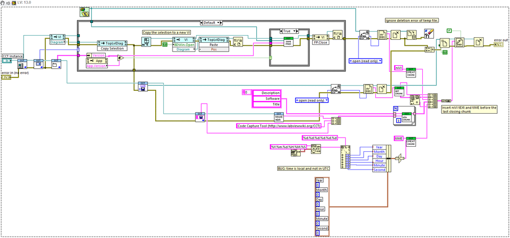

@paul_a_cardinale wrote:
@tst wrote:
@Andrey_Dmitriev wrote:
I will really appreciate if you will be able to implement the same for LabVIEW Snippets (I mean Edit->Create VI Snippet from Selection - Retain LV Version)...
While the CCT, linked to by UliB, doesn't have this specific option, it does have the option of selecting the version to save the snippet to.
I don't remember offhand the details of what happens if you select a version which doesn't support features which exist in the code you're capturing. A quick test shows that the image appears correctly and that LV tries to do the standard mutation. I haven't checked what happens when there is no mutation path.
In theory, it shouldn't be difficult to add a checkbox to default to the save version of the VI.
Also, it might be useful to have the snippet option available when no selection has been made (and then you need to select the entire BD). That change is probably a bit more complex.
I looked at the Code Capture S/W.  I'm not willing to search for, and dig out, the part that saves a snippet.
Fair enough. If you do want it, in the top loop there's a store case with another case structure inside which calls the snippet creation code. This is what creates the actual binary chunks in the PNG image (it also shows the backsaving option, as you can see the snippet is in 2013 format):
There's a separate point in the code which adds the snippet graphic. Looks like this basically just creates a temporary VI with the selection and then calls the SFP method before reading the binary data of the VI file.
Also, unlike what I said, it looks like the CCT does allow a snippet if you select the ALL option in the BD (although it looks like by default the NONE option is selected, but I haven't gone back to check how it behaves in all cases).

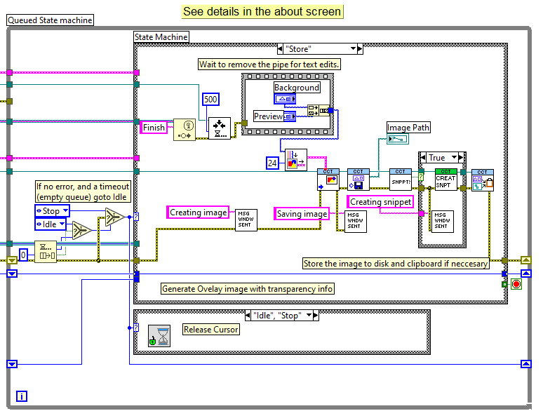

I don't see a loop.  I don't see a "store" case.
The VI "Code Capture Tool GUI__CCT.vi" (UI for the CCT) has the while loop with the main state machine and the "Store" case.
The VI with the green banner "CCT_Snippet__CCT.vi" is the VI tst showed in his message.
Message 14 of 27
(953 Views)
