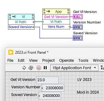

Yes, in LV2024 I have exactly same output as shown on your screenshot.
But I have one empty VI  which is opened in 2024 and "downsaved" to 2023 with this tool, and if I paste your code into it, then it appeared as shown below:
(This VI can be opened in LV 2023 without any problem).
That's an interesting LabVIEW quirk that leads to a bug in my code.  My code assumes that the "Saved Version" property is the version that it was saved for; but it's actually the version of LabVIEW that last saved the VI.
I'll have to fix my code.

Here is the fixed version (1.01).
Now the defaults should always be correct.
