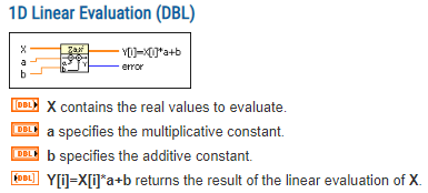

Another option would be to use linear evaluation (offset and slope have been discussed).
Also works for 2D arrays, of course.

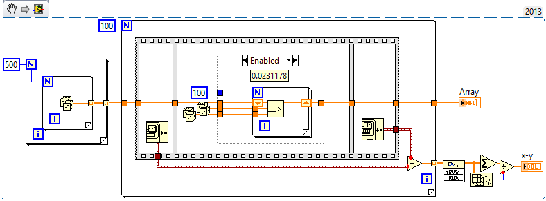

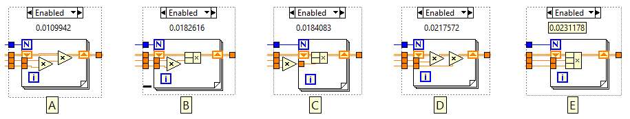

Here's my test bench. And it's tricky, Sometimes any change makes the time double, and a random change makes it go back. I feel like these values are "realistic" though, after giving each option several go's. I used a median before the mean, as strong outliers added about 20% noise on the results.
The results:
Definitely some unexpected weirdness going on here!
A being (much) faster then B? Weird!
A being (much) faster then C? Weird!
B being faster then C? Weird!
E being the slowest? Sad. A factor 2.3 is quite a bit slower... This could\should be just as fast as A.
DISCLAMER: Tested in 2013... 2017SP1 is a bit faster for all cases, but the order and ratios are pretty much the same.
EDIT: It get worse:
5.5 times slower then the fastest way... Smiley Sad
And, just for the record:
They are within the noise.  I would expect them to actually compile to the same thing due to optimizations that the compiler does such as moving that first multiply outside of the loop.

That it's slower when you wire the scalars on top isn't that surprising. There's some threads on LV memory management, and if you wire an array on top it usually work in place, while a scalar on top forces it to create a new array.
/Y
