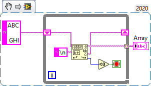

You've probably figured a way around, but here's one that specifically looks for each newline character and splits the string by that.

This works, it's just a lot messier than Scan From String would be:
(4,281 Views)
