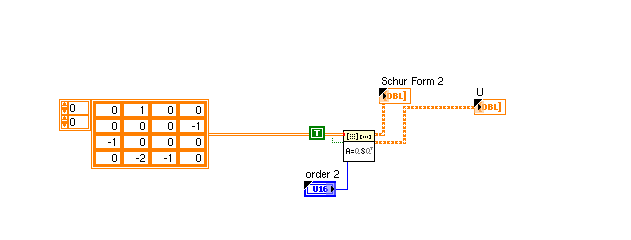

Alright, i am banging my head.  I am trying to replicate a simple example from a paper.  (http://dspace.mit.edu/bitstream/handle/1721.1/1301/R-0859-05666488.pdf?sequence=1) Basically it is doing

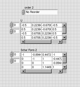

a schur decomposition.  Z would be the input, and U would be the orthogonal matrix out.  I am using the Schur decomposition vi,
and it is giving me a really close answer, but the signs are not correct.  Can anyone figure out what i am doing wrong?  I tried all combinations of
the ordering enum, and still nothing was correct.

The decomposition is not unique so you could get a different value.
You could verify that the results are correct by verifying that U'ZU = Schur Form 2 is an upper triangular matrix, which is true in this case.
BR
(5,618 Views)
Perfect, thanks so much, everything looks good.
