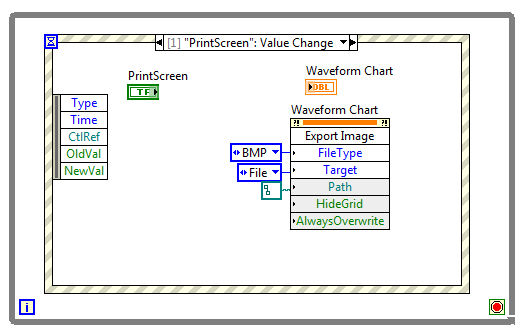

If you are talking about a graph or chart, create an Invoke node for the graph and select Export Image.  Capture.PNG
