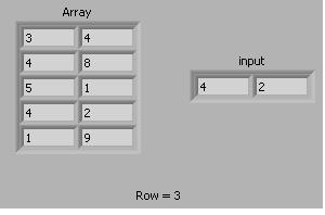

Not scalable if you want to match only part of a row, but assuming you want to match the whole thing, here is a fairly concise way.
Message 9 of 15
(7,627 Views)
Sorry, i might have been misled by Damien's post. It seems you are not searching for an element, but for a matching row.
