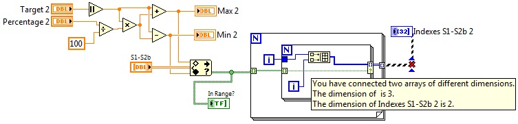

Another option would be to reshapae to a 1D array and use search-1D-array in the boolean output of the "in range and coerce" function. Here's an old example.

@Ivan899 wrote:
Probably I am doing something wrong...
The outer for loop tunnel should be concatenating instead of indexing.  I would move the IR&C function inside the for loops and autoindex the original array.  No need to create the intermediate boolean array.

Hi Ivan,
as others noted you have to change the output tunnel mode.
- You also placed the Abs() function in the wrong place.
- You didn't use the snippet I provided…

I have been thinking that the row and column indexes are the i values of the two loops, so why not present it that way?  And Thanks to Darin for pointing out that moving IR&C inside the loop simplifies things. So now I create an array of cluster of row, column indexes.
