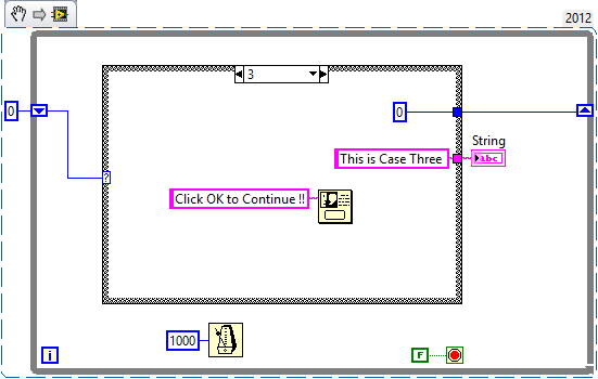

Maybe the example i have made will explain the problem more clearly : ( It is done in LV2012)

Hi Moga,
with this OneButtonDialog function you cannot use any timeout, it will wait for user input forever.
But you can implement your own (modal) dialog VI…

This will not work, as the One Button Dialog vi will wait for the user click forever.
You need to replace the One Button Dialog vi with your own vi, managing the 5 seconds timeout.
See the attached example.

Thanks folks... that now confirms the simplest way to achieve the Auto Quenching dialog box is to create a VI with the required timing functionality built into it !!

Accepted by topic author MogaRaghu
Mission Accomplished !!Smiley Wink
Full code attached as a ZIP file. Unzip and run the Main.vi
