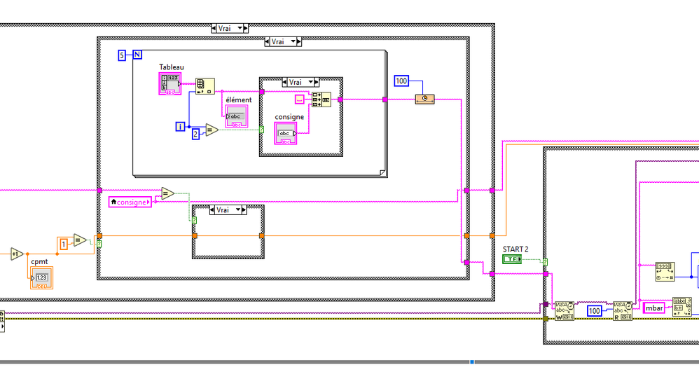

Send Array of String element by element outside loop for to VISA Write
Please, I want to send an array of string element by element to VISA Write, without putting the function VISA Write inside the for loop, my array contains a list of instruction to send one after the
other separated by a delay of 100 ms, I'm almost to the answer but I remain how to extract element by element from the loop and send them on VISA Write
Thanks to all.

Hi Ayoubas,
This doesn't make sense.
Call the VISAWrite inside an (auto-indexing) FOR loop!
(2,245 Views)

@paul_cardinale wrote:
You can use the function "Array to Spreadsheet String" to convert your array to a single string that you can send to VISA with on call.
Many instruments do not like it when you do that.  They like having time to process commands before another one comes in.  The OP did state that each command needs to be sent with a 100ms delay.  From another thread, I know this is coming straight from the instrument's user manual.
The real solution is to use a FOR loop with the VISA Write inside of the loop, autoindexing the array of commands.
(2,215 Views)

If the task asks for a FOR loop, you use a FOR loop (and it you need to stop early, add a conditional terminal).
Unless this is is some convoluted exercise, it makes no sense to limit yourself to a subset of the available tools.
Can you explain your aversion to FOR loops? Maybe they are misguided!
(So you are already using a FOR loop, but you are throwing everything away immediately except for the last value, misguided local variables, using fake (instead of real) autoindexing, control terminals inside a tight loop, etc. These are all indicators that you might need to work on your coding skills first. We can help!)
