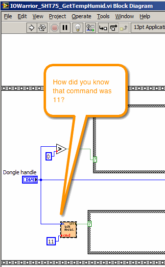

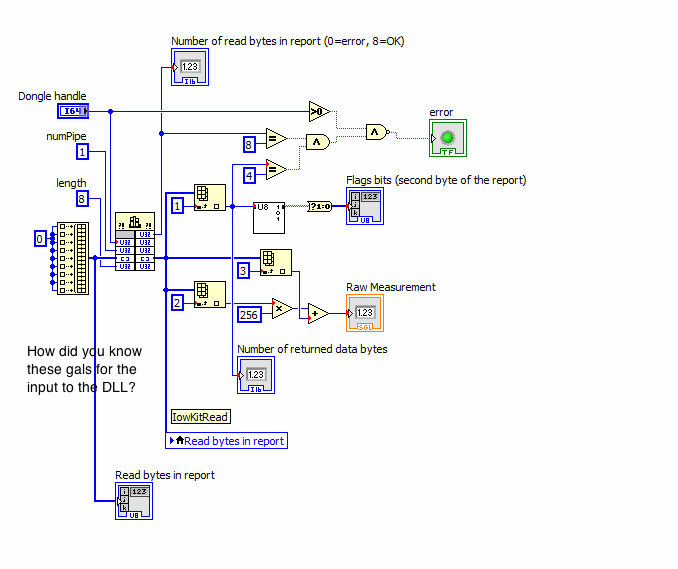

My question is how did you figure out the binary code to read the T and RH from the  iowkit.dll
I want to read the RAW TICKS from the device that represent pressure. They go from 0 - 65535 and I have spied on it with WireShark and can not wrangle the binary code to read the raw ticks I am after.

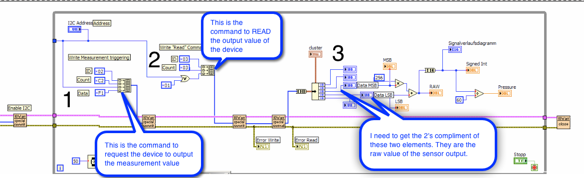

Cameron... Wondering if you knnow how to get a 2's compliment for a 12 bit value in LabVIEW?
I am looking to get the code to communicate to this top secret Sensirion product.
Anyone know if I am properly sending the commands at 1, 2 and 3 of the image below?
At issue, I think, is getting the two's compliment of the two 8 bit registers at Data LSB and Data MSB using LabVIEW...
I have been working with the wizards at http://www.codemercs.com/258/?L=1 who have been EXTREMELY helpful.
They have an AWESOME I2C to USB converter that you can get OEM devices to work for your I2C project. It is a single channel version of the NI-8451
Anyone out there can figure this out so I can read the RAW TICKS from the Sensirion SDP6xx product line?

Forgot to insert image...
Message 6 of 28
(5,517 Views)

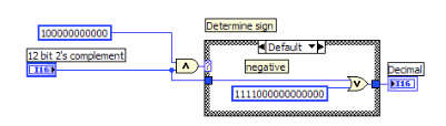

Here is a two's compliment for a 12 bit integer created by Xu from his post:
Cameron.. See how to do with this..
Do you want 1,2,3,4,5,6,7,8,J,K,L,M or J,K,L,M,N,O,P,Q,1,2,3,4? Or something else?
Then take 2's complement?
Message 7 of 28

Complete LLB with two's compliment implementation but I do not think I did it right...
Any hints to help?
Anyone on the planet have any success talking to the Sensirion SDP6XX series in LabVIEW?
What up with the 12 bits? That's 0-4096 but I KNOW the device goes from 0-65,535 with the "zero" at 32,767 and full scale at 65,535

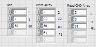

I am still working with this silly thing! Can anyone figure out how this thing works> The datasheets and sample code are not clear.
All I am looking for are the few hex values to do the following:
1) Set up the measurement as shown in the 1 in the graphic.
2) Send the correct value to read the desired variable as shown in 2 in the graphic.
3) How to cipher the output.. I want the full 16 bits...
See this video....
http://www.screencast.com/t/VWFYx7mc
See if you can figure out this crazy thing! I am sure I am missing something VERY SIMPLE!
In the end I really only need to know the right values to put in the graphic below...
What am I missing??

I apologize for taking so long to respond to this forum, but I am a bit confused as to what you are looking for.  Do you want to ascertain the two's complement of a 12 bit or 16 bit number on the output?  Doing this with a 16 bit unsigned interger should be fairly staight forward.  Does this VI help at all?
Cameron T
Applications Engineer
