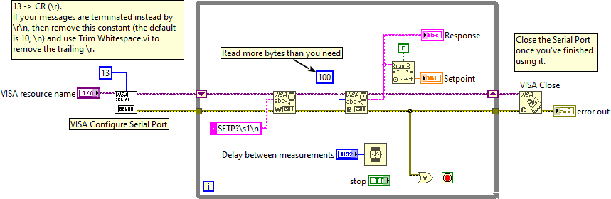

Here's an example image demonstrating some of those points:
You can set the "Delay between measurements" appropriately to repeatedly poll the setpoint, and by using the Termination Character property (configured using VISA Configure Serial Port) you don't need to wait between the Write and the Read manually, and instead will always receive a "full" message.
Take care if your messages end in \r\n, you'll need to set the term char to the last character (\n, the default) and then trim the trailing \r character. LabVIEW has a VI that will do that for you here: Trim Whitespace.vi

Thank you both for the replies! That video was very informative, seems like I was doing everything he said not to do 😫 by using the simple serial example. I think I'm on the right track now, I'll know more when I'm back at my computer. I attached some screenshots from the instrument manuals. Seems like I can use \r or \n as terminators if I'm understanding correctly. Two quick follow up questions...because I always seem to have more.
