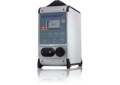

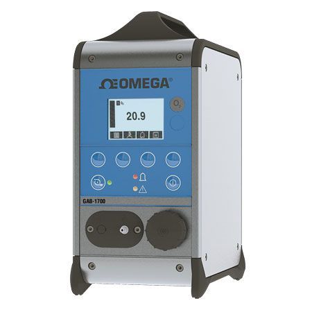

Just curious, is it an Omega GAB-1700?  Looks like this:
If so, it's a rebranded Servomex 5200 series:
I have a driver written for the Servomex (which supports the dual-channel option as well), PM if you want to try it.
