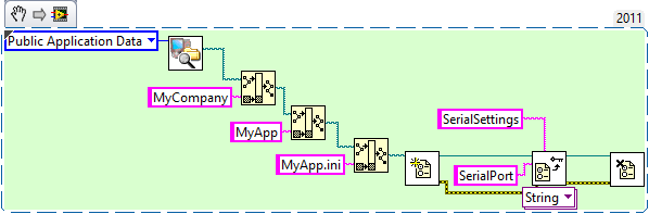

Yamaeda simply reminds you that Microsoft's recommendation is not to write application data into the %ProgramFiles% subfolders, use %ProgramData% instead.
Here is is an example following his suggestion:
Paolo
LV 7.1, 2011, 2017, 2019, 2021
